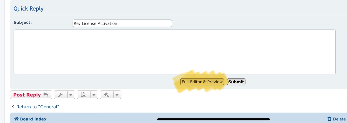

Can you select Full Editor & Preview, below the reply window, Select attachments and upload the .fcfx, .msg.txt and .c files within the project folder.

I do not understand the first question you asked re Full Editor etc. I cannot see this on the forum page

Full editor and preview refers to the marked button in the picture below.
Once you select it you can use “Attachments” below the text box to add the requested files.
