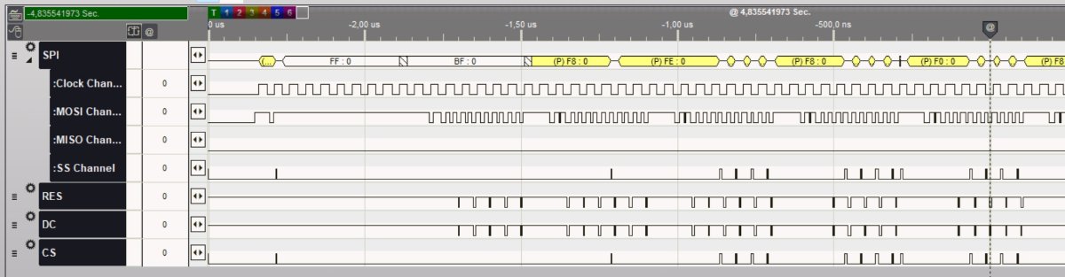

Re: Compilation error when using ST7789V component with ESP32.
I found a solution:
If I enable the CS pin and enable the CS pin in Toggle mode, the hardware SPI works. Hooray!
So I have to use Chip Select pin to make it work.

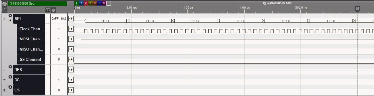

An observation:
If I disable CS Toggle mode, the display no longer works with the hardware SPI peripheral.
In this case, the MOSI, RES, DC, CS lines will be noisy as if they are in a high impedance state.
In the screenshots below, the threshold voltage of the logic analyzer has been set to 1.65 V. Regards,
Sasi
An observation:
Sasi
