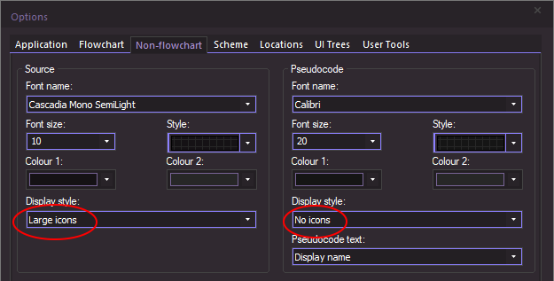

Unzip the attached file and put the contents into the "GFX" folder of the Flowcode installation location, replacing the existing files with the same names.
This will allow all of the Code and Pseudocode display styles (except the "Default" styles) to show the currently-simulating line. The style can be changed in the "Non-flowchart" tab of "Global Settings" (under the "File" menu):
text view style options.png (21.9 KiB) Viewed 14383 times

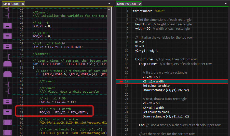

Here is an example of these views during simulation after this change has been made:
text view simulation.png (122.26 KiB) Viewed 14383 times
