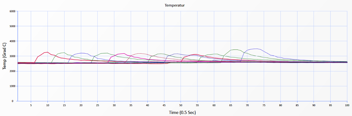

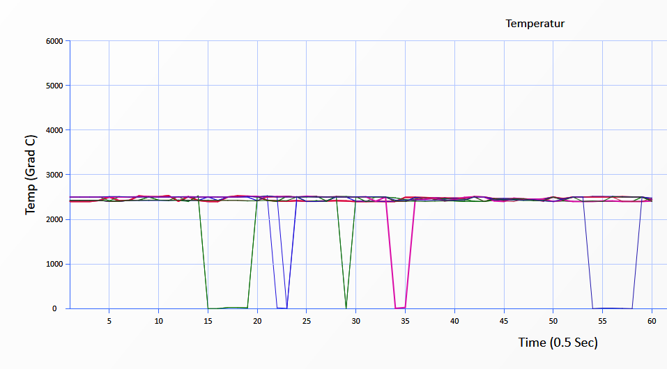

If I use one 8 Channel multiplexer and record the temperatur with the appdeveloper it's working nice.
If I touch a sensor the temparetur will increase. ( Temp is temp x100)
but if I add a second 8 Channel multiplexer and increase the number of sensor to 12, all channel are wrong even the first 8channel.
As if the MCP960 is wrong config.

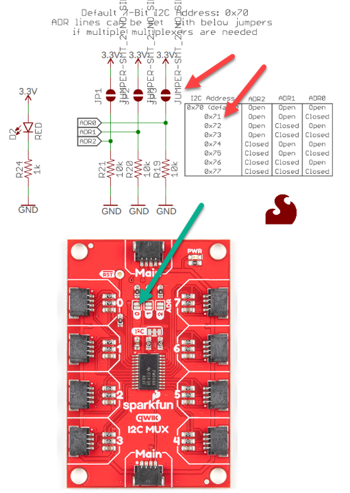

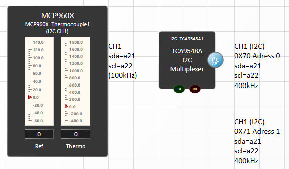

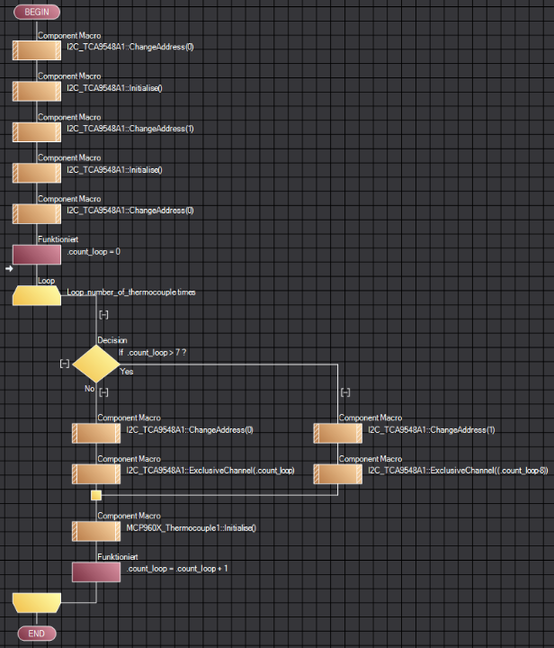

For the second multiplexer I changed the adress:

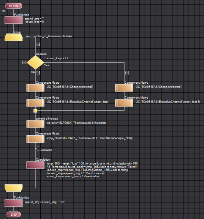

My macros for the Sensor:
Thermocouple_get_strg.fcm
(4.47 KiB) Downloaded 236 times
Init_thermo.fcm
(3.63 KiB) Downloaded 240 times

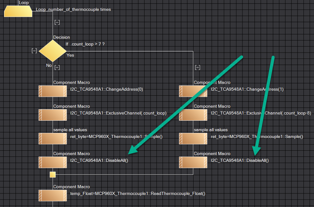

Ok I found what i did wrong
I have to make an additional disableAll when I have finished reading. Then it works nice.
I suppose a disable channel would also work

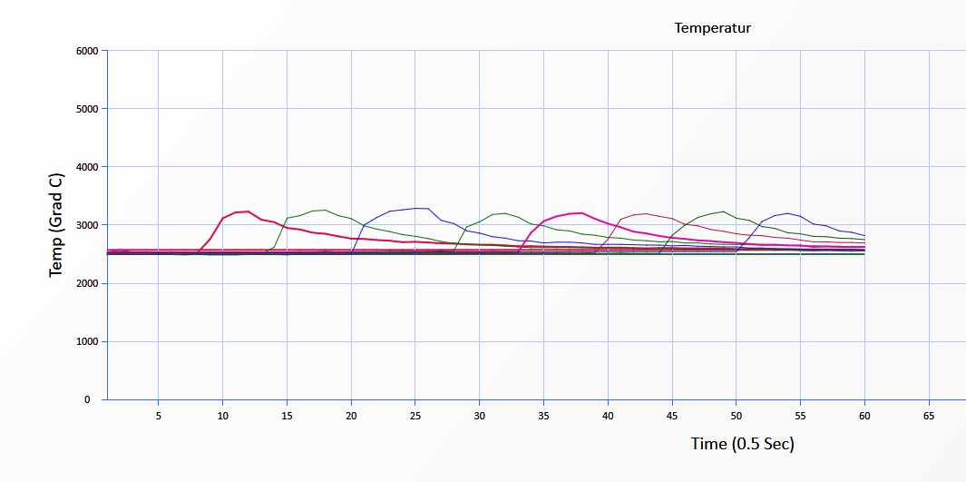

All 12 channel are fine
