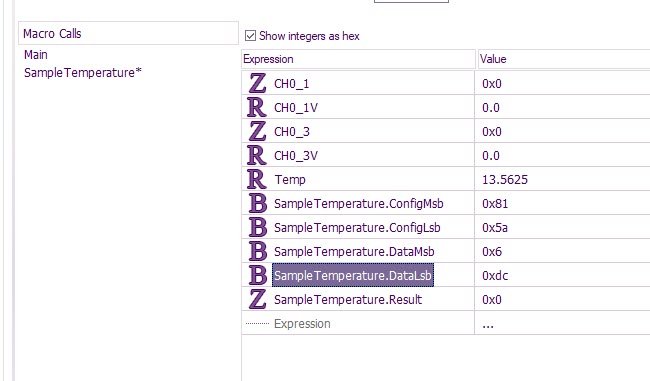

Hi Team.
What would be a nice feature for myself at least in FC would be if the watch window can display the Hex and Binary number and select able as the dec or hex is currently in the window,
May be is is already there that I am not aware of it ,

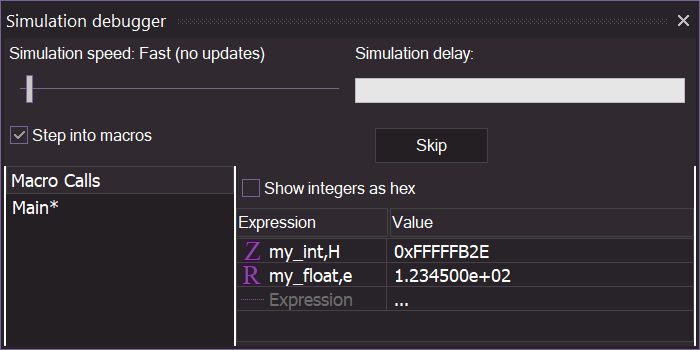

The v9.2 update has now been released and includes format overrides for variables in the Simulation Debugger watch window. These can be added by adding a suffix after the variable within the watch window entry (for example, "my_var,b" will display that variable's value in binary).
The supported formats are:
  • ,d - decimal
  • ,h - hexadecimal (lowercase)
  • ,H - hexadecimal (uppercase)
  • ,b - binary
  • ,e - standard form
Standard form is only supported for floating point variables, and the other formats are only supported for integer variables.
These suffixes only work with single variables; expressions and arrays are not currently supported. Variables and expressions without the suffix will be displayed using the default settings.
Integer variables can have their values altered in the watch window using decimal, hex and binary representations. Floating point values can only be entered using their default decimal format (e.g. 0.00234).
