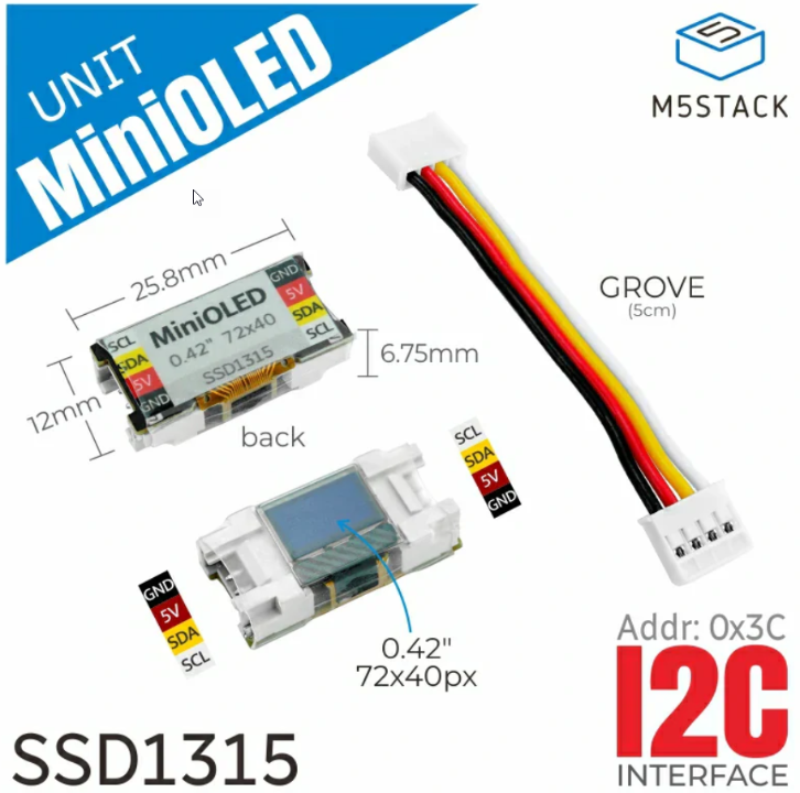

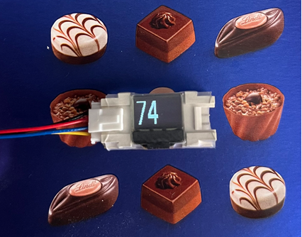

There is one more display that I would like to use. It is very small.
Not much bigger than the two grove plugs or a small swiss chocolate
and works with 3.3 Volt or 5 Volt.

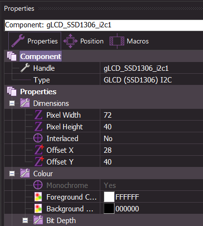

I have connected it with the component SSD1306. it works but the pixels need a strange offset. Can you create a component for SSD1315?
working but....
https://shop.m5stack.com/products/mini ... 0-display
Offset is not practical to use
