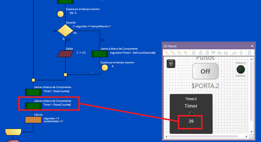

I attach a file where I believe that the reset of the timer 1 component does not work.
In the program, after the start of the counter, it sets its value to 0.
After the specified time has passed, I stop the counter and reset the counter variable and also place the "ResetCounter" block. This is correct.
On the second startup with "StartCounter" when passing through the "GetCountSecond" block, I observe (see attached screenshot) that the value that appears in the timer 1 component does not start counting again from 0. It continues counting from last value it stopped at.
In the "StartCounter" block I have selected "ResetCounters=1"
But no reset occurs
This is correct?
Resetting the TIMER1 component does not work

Re: Resetting the TIMER1 component does not work
I also think it should, therefore I have changed the component, so it does.
To try the component.
Place the attached component.
Also, within your flowchart Decision branch you are using AND which is bitwise AND.
You will be best using && instead as that is logical AND
%ProgramData%\MatrixTSL\FlowcodeV10\ComponentsIf Flowcode is already open, then you will need to reload your project for the new component to work
