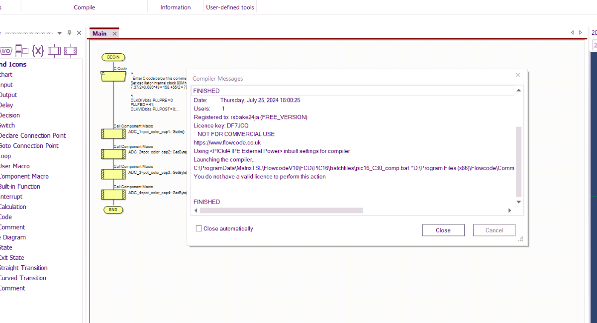

when I try to compile to hex i get an error message " you do not have a valid license"
I have activated my license.
It shows the three items I purchased pic8, pic16 and ARD
Luckily my v8 appears to still be working.
Can you help
Roy

Re: cannot complie to HEX after installing V10 Paid licence
Sorry you are facing licensing issues.
We are investigating and will hopefully find out what the issue is ASAP.
Have you Refreshed your licence since activating your account with the key?
Then restarted Flowcode?
I'm assuming you have.
Hi Roy.
There was an issue with our sever, which has now been fixed.
Many thanks for reporting this.
Can you now please reactivate your licence within Flowcode

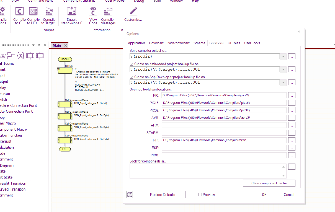

I get the message "pic16 compiler toolchain is not installed Please visit......
I have tried reloading pic16 toolchain but I suspect it just overwrites the V10 location.
I tried directing the program directly to the Compiler in the option boxes of v8
$(compilerpic16)batchfiles\pic16_C30_comp.bat changed to V10 location.
D:\Program Files (x86)\Flowcode\Common\Compilers\pic16.
There is also the original version in the C: @ C: \program files (86)\flowcode\common\compilers\pic16\
I saw one message on the form suggest removing a registry entry. Still looking to find it again. It covered not using a compiler after installation and then uploading another.

To fix this, you will need to add an entry in the registry to point Flowcode v8 to the pic16 compiler toolchain. These instructions assume Flowcode v10 is correctly set to compile a pic16 project.
- Open Flowcode v10 and open File...Global Options
- Copy the entry for the PIC16 toolchain location in the "Locations" tab

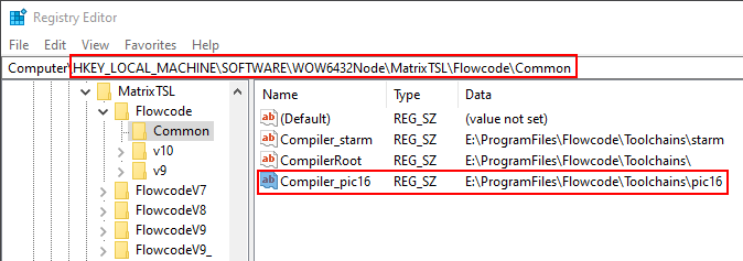

- Open Regedit and create a new string value here:
--> HKEY_LOCAL_MACHINE\SOFTWARE\WOW6432Node\MatrixTSL\Flowcode\Common - The string value should be named "Compiler_pic16" and its value should be the same as the location copied from the v10 location in step 2 above
- Close Regedit and close Flowcode v10
- Open Flowcode v8 and create a new PIC16-based project and try to compile it
