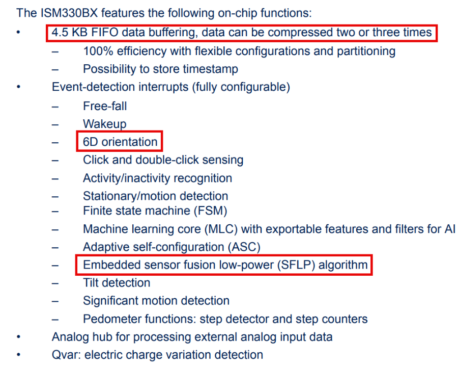

Would it be possible to create components for new IMU ISM330BX and LSM6DSV16BX.
Especially sensor fusion, FiFo and I2C to I3C would be interesting for me. Both IMUs support this.

I can do without I3C and FIFO.
I am interested in the fusion data yaw, pitch roll.
So I can send these values to the Appdeveloper with USB.
In this way I don't need to calculate fusion with Flowcode.
Fusion yaw, pitch roll

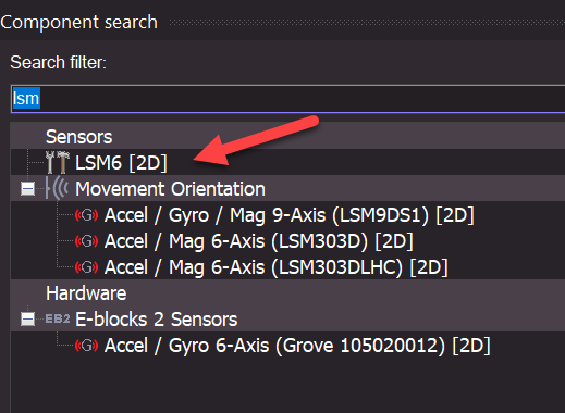

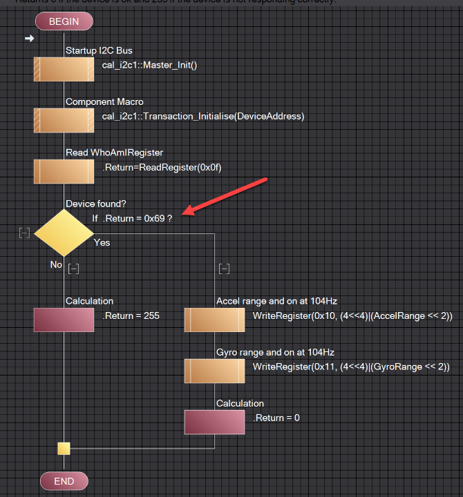

Would it be possible to create a new component LSM6 that works for different versions? Also with a name LSM6 .
There are over 40 boards with an LSM6
I found a component for the LSM6ds3 under:
FC_Comp_Source_AccelGyro_6-Axis_Grove.fcfx
I bought an LSM6ds3 and an LSM6DSV16BX board.
The LSM6ds3 works
but LSM6DSV16BX not yet.

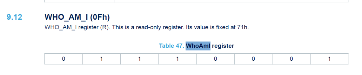

I looked in the component source code and saw is tested on 0x69. The LSM6DSV16 has 0x71.
Can this be extended?
from the LSM6DSV16BX.pdf

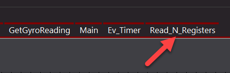

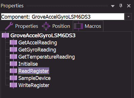

There is also a read N register in the component, but the macro is missing in the finished component

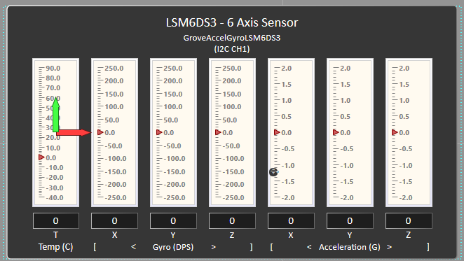

Sensor both with LSM6DSV16BX and qwii:
graphic part is nice an exist on component FC_Comp_Source_AccelGyro_6-Axis_Grove.fcfx:

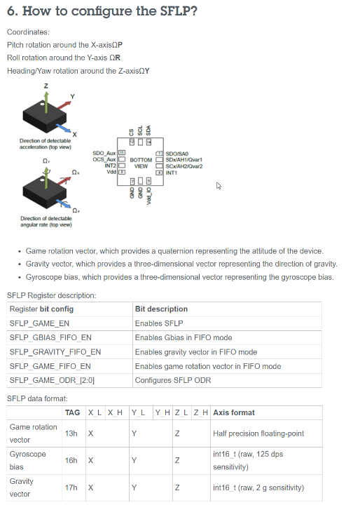

Half precision floating-point ?
I have made progress with the LSM6
I can read and write register
This also works with read n times register.
Only there I should read an precision floating-point.
Can I do that in flowcode embedet or in App Developper?
Read fusion data:
