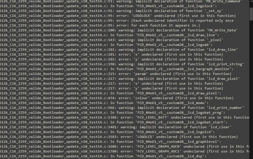

When I add global variables, constants and variables in Parameters of the component macro, some macros can't be compiled. I don't know why the variables in parameters don't work for some macros of my user component. Work fine like this with the FC5. So to compile and progress I followed your advice and I added a C code with variable declarations. Work fine with the ASCII characters var declarations and my logos. But the problem with the variables in parameters is no clean. This problem exist for lcd_draw_line, lcd_draw_pixel, _pixel, lcd_print_string and other user component macros. I will send you the Custom20.
You can see on the print screen, I have also a problem with global variables called in the C code of the Costum20 component. No problem with FC5 but here, this global variables are undeclared. For example FCV_LEVEL_GRAPH_ADC0 ...
This variables are used in macros of the project without problem. This problem exist only in the user component.

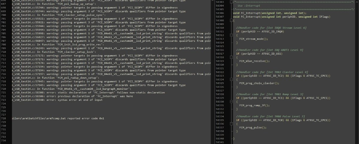

I can't compile my project with success because I have also error from the Interrupt section. You can see on the print screen the partial void declaration of Interrupt section at the end of the C file. I have no idea how to do to resolve it because this lines are write by FC.

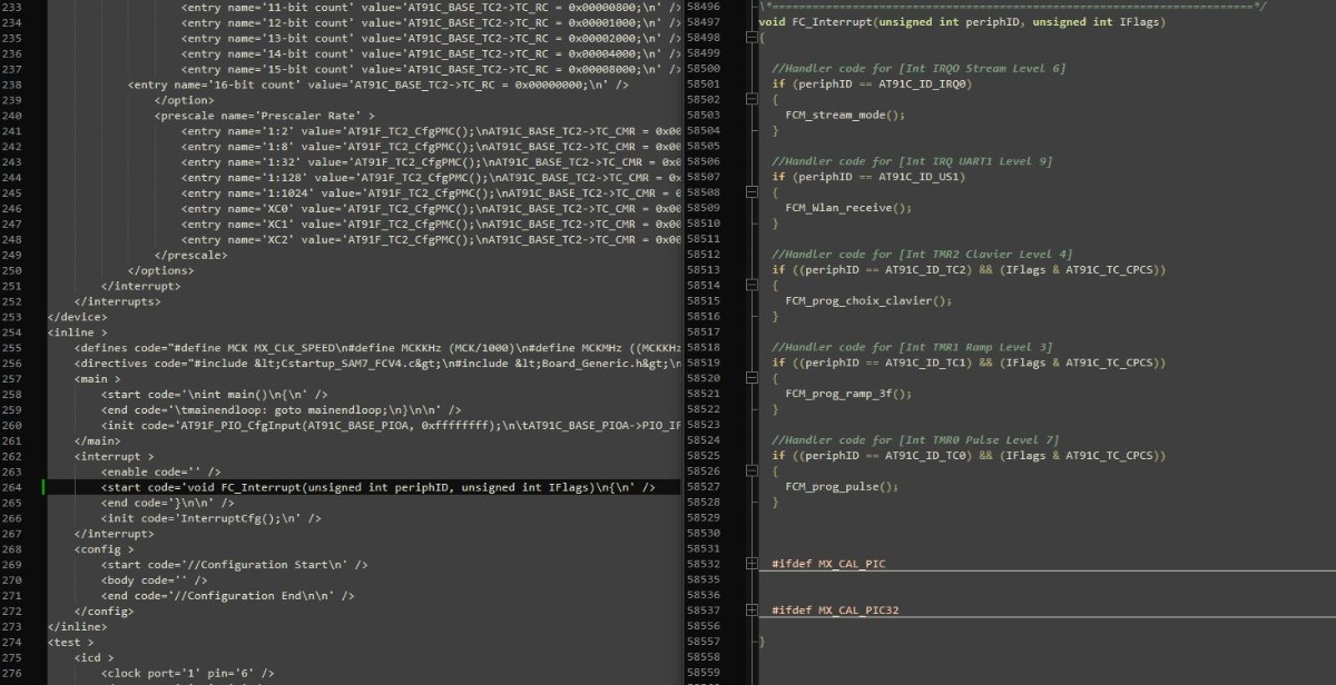

I find the Interrupt enable code and void declaration code in the AT91SAM7S512_64.fcdx file.
I removed the first void declaration but this line is always present in the compiled c file. I search the good .fcdx file and how this file is used by FC.
EDIT: I was not in the good directory to update the AT91SAM7S512_64.fcdx file. I removed the first declaration of the Interrupt void. The last error is always here. I added USB serial component in the project and we can see the USB Component code in the Interrupt void. Probably a problem with the syntax of the Interrupt init code in the .fcdx file.
Re: Importing embedded project from FC5 to FC10
I just fix the problem about the end of input error, "}" was missing in a Custum20 macro.

I have now new error from the custom20 component. In fact all parameters of the custom20 component macro are "undeclared" for the compiler.
I will declare my variables in a C code per macro tomorrow.
EDIT: I have find why all parameter variables of the user component macros are "undeclared" for the compiler, we must use the Flowcode prefix of the variable in the C code of the component macro. I will open one topic per problem in the user components section of the forum because many things about the C code are different between FC5 and FC10.
