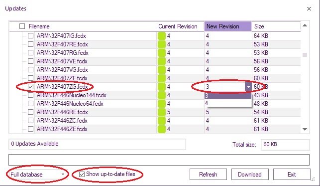

Alan_37
Posts: 205
Has thanked: 57 times
Been thanked: 28 times
Re: Error compiling to Target
Post by Alan_37 »
Hi, LeighM Thanks for your reply
Can you please explain how do I do that cos I don't see any roll back button
in the update section.
LeighM
Posts: 558
Has thanked: 109 times
Been thanked: 302 times
Post by LeighM »
Then click the Download button
