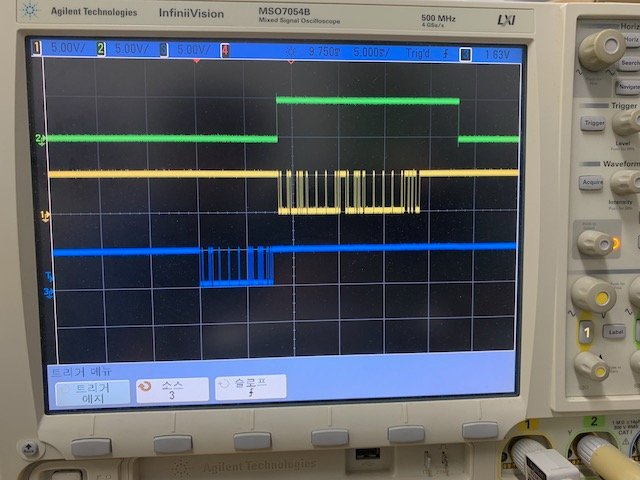

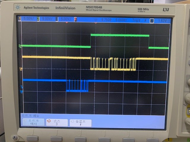

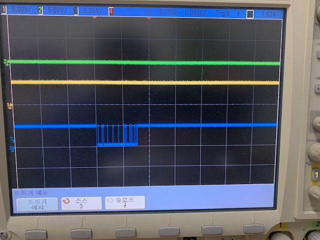

Re: Modbus RTU Slave error after updating Flowcode v10.1.2.40
I did as advised above, but it still doesn't work.
For reference, I'm uploading the oscilloscope waveforms.
1ch TX
2ch re/de
3ch RX
The first picture is after connecting the RS-485 device connected to the PC to the device programmed with FC10 in the RS-485 method, and then directly connecting the TX signal of the device programmed with FC10 and the RX signal of the RS-485 device on the PC. Communication works fine.
However, if I remove the direct connection between the TX signal of the device programmed with FC10 and the RX signal of the RS-485 device on the PC, the waveforms appear as in the second and third pictures, and then communication does not work.
1ch TX
2ch re/de
3ch RX
