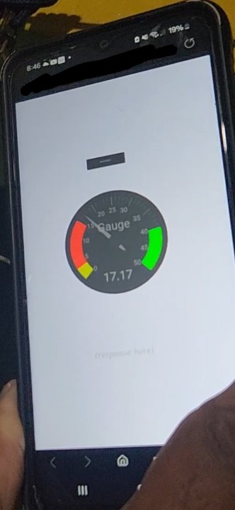

My Embedded Project I am working on Is, I added (2) hx711 in my Program. "Running in the Main Loop".
I want it to update the Guage's using the HTTP Protocol. IN MY WEB APP
I only created a Template of (2) Gauges in the Web App Only,
I will Need assistance along the way, while I work my way Through with it.
PLEASE AND THANK YOU
Ryan

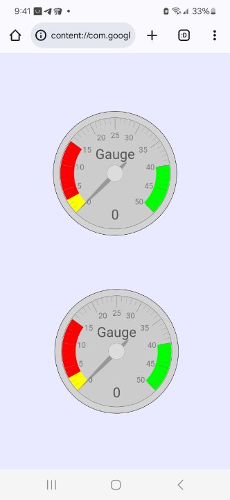

Hi again,
Has it related to the Ranges "0,1,2,3" on the Guage is it possible to add another Range??
In the web app above, am currently using those 3 RANGES for a specific purpose. I would like to Fill that area using it as an indicator for something else in the same Program. THANKS AGAIN.
IF THATS POSSIBLE.
Ryan

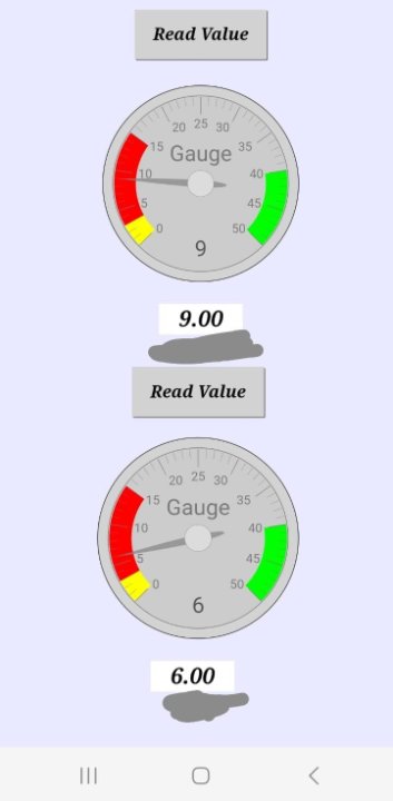

Hi Steve
I did what you told me and am getting the values on the Guage now
Thanks, a lot.
There's something else that I want to do, but I haven't figured it out as yet.
I want the actual value "number" to be displayed in the App Below the Guage as well.
How do I do that?
Thanks, a lot.
How do I do that?

Re: WEB APP HTTP Protocol
You could add a separate text label and set its text at the same time you set the value of the gauge.

hi Steve
I still haven't got the number to be Display inside the Web App
I did what you told me. It is showing undefine. Probably I miss something
I attached the Web example.
I also attached the Image of what I have in my embedded project. The calculation
what am I doing wrong?
Your Fetch component is set to call the "SetGaugeValue" when a response comes back from your device. This has a single value as a parameter called .Data by default. You just need to pass this .Data value to the text label, and you need to do this in the macro that is being called when Fetch returns (i.e. the SetGaugeValue macro).
What is problematic is the Gauge SetValue takes a float value as a parameter and the Label SetText takes a string. So you will need to do a little conversion.
The attached should hopefully work. As well as doing the above, I have also removed the unused extra parameter and the unused macro.

Re: WEB APP HTTP WORKING AS EXPECTED
Hi Steve,
Thanks, a lot for your "HELP" really appreciate it.
My app is "NOW" working as "EXPECTED"
