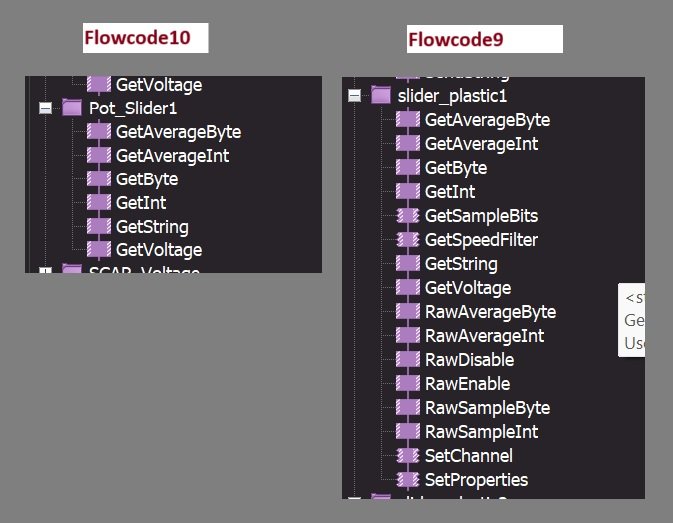

I wanted to compile a Flowcode9 project in a Flowcode10 environment, but I received error messages because Flowcode10 does not recognize all the plastic_slider component commands that I used in Flowcode9.
Was the number of commands intentionally reduced in version 10?

Yes, they were deemed as too complicated for a lot of users.
If RAW is what you want to work with then you can use the ADC Template.
Just use the search magnifying glass and enter ADC.
If Raw is not required, then just remove those functions from the user macros.
