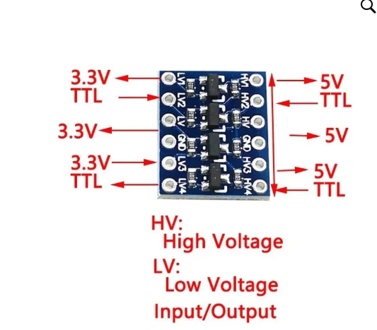

Yes I am aware of the display datapin max. can handle 3,3V. I am using some leveshifter, but anyway, thanks for your tip
I will test.
The testprogam is arix´s program with an Uno, normally I use the ESP when use the ILI display, much faster
I would only be helpfull and test your new update, and as mentiod, with the new update component the display work fine with the Uno but only in softwaremode, but not if I use Ch1 or Ch2 and the display is very slow, have always been.
Hope my explanation make sense Martin (my english is not 100%
), and if I can do something let me know
Br Jorgen
Br Jorgen
- levelshifter.png (191.54 KiB) Viewed 10243 times

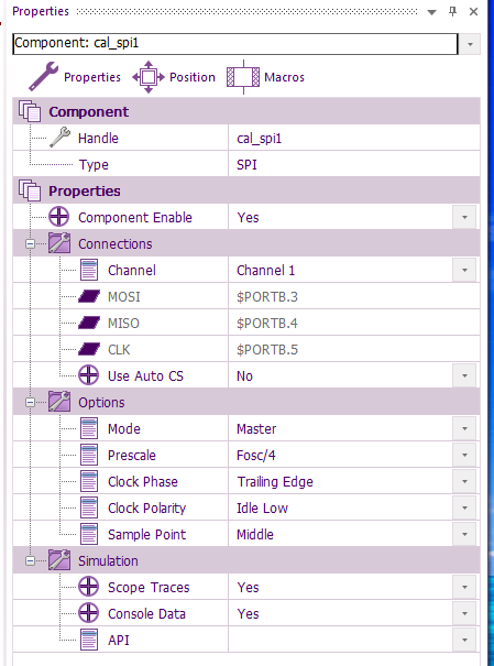

I have just tried the project you attached and it works OK on the Uno with SPI set for Channel 1.
I have modified the project for my hardware and to stop hello world text from flashing, which is expected the way it was set up.
With Channel 1 selected within your project to check SPI is the same as my settings, try this.
View menu then select Component debugger.
Select Expose full component tree in property pane.
You can close the Component debugger.
Within Properties scroll down to cal_spi1 (it's a fair way down!)
Check the settings are: If for example Clock Phase is set for leaning edge then the display won't work on the Uno.
Also speed will be an issue for level shifters.
You ideally want the presale as /4.
I'm not sure if your level shifter will work with the SPI speed?
It works in software mode as the speed is a lot slower.
My suggestion, lvl shifts at up to 32 MHz ok as it also works on ESP32, even though its not required.
