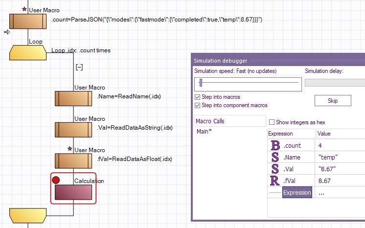

Just checked the component source and ReadDataAsFloat seems to be working ok for me. What chip type are you using and I'll test again on there just to check it's not a specific CAL/toolchain issue.
Screenshot 2024-12-02 213912.jpg (69.04 KiB) Viewed 9941 times
