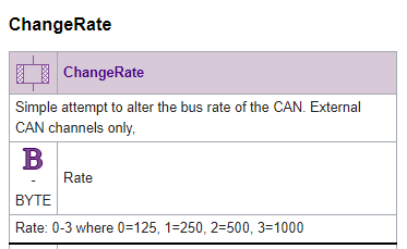

If you look at the ChangeRate function it shows:
ChangeRate function.png (9.5 KiB) Viewed 1755 times
Therefore the ChangeRate macro allows what you are inquiring about.

Hi, thanks for your answer.
I test the macro but it only work with external CAN and MCP2515. I want to use the internal controller of the 18F26K80.
