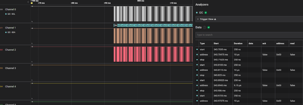

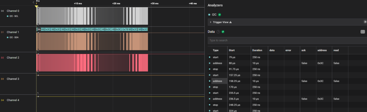

The I2C address in the new component is set to "custom" and I choose "0x3C" (which shows up as 60).
But when I look at the I2C signal on my logic analyser it sends 0x00
The data send over the I2C bus with address 0x3C (60) (shows up as 0x00)
And the data over the I2C bus with the SSH1106 protocol (and address 0x3C)

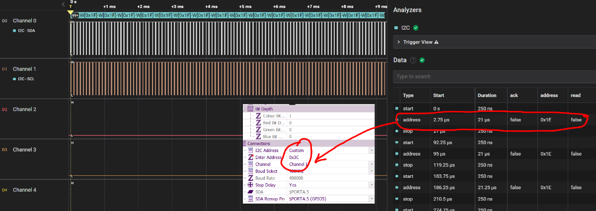

Flashed the board again with the new component, but still the I2C address is not what it should be..
Posts: 2372
Has thanked: 752 times
Been thanked: 811 times
Re: Change I2C address SSD1306 component
I can see why there is confusion.
with the SSD1306 by selecting 0x78 then that is the 8bits for a write.
The transaction_Initialise right shifts so 0x3C is stored which is the default address.
If a Transaction_write is called then the 7bit address will be left shifted so 0x78 is sent
If a Transaction_Read is called then the 7bit address will be left shifted and OR'd with 1 so 0x79 is sent
You are entering 0x3C, which is entered as a Read.
That means the address analyser will see for the default address is:
0x3C>>1 = 1E
You was not to know that, nor did I util I just looked at the code I2C Cal
I will ask for the reason its done that way.

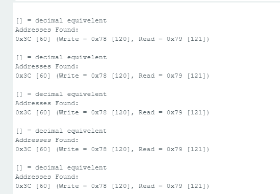

What you could do to find the correct address to add is use the Address sniffer/scanner
It will show the Write address, which is what you require to enter in the text box
SSD1306 default adress 0x3C.png (23.6 KiB) Viewed 5376 times
In the case of my display, it was 0x78

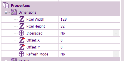

But... this can't change the amount of pixels (the OLED actually has 74 x 40 pixels), so I need an offset to display what I want.
Have you tried adjusting the properties to match your display?
SSD1306 properties.png (14.04 KiB) Viewed 5297 times
