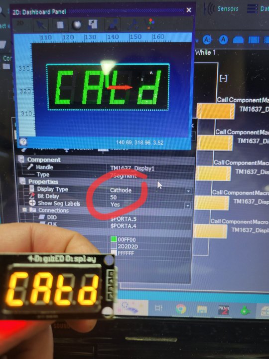

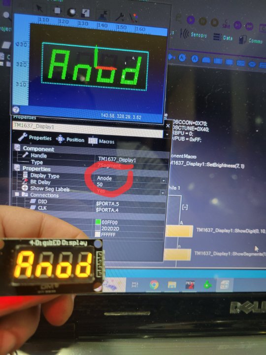

Looking at your image for FC8, you have Display Type set to Cathode.
With the FC10 version, you have Display Type set to Anode.
Could that be the issue?

Yes, I tried several settings and I did a print screen at a random setting. Anyway, in FC8, it works even if I put common anode or common cathode, probably a component leak...

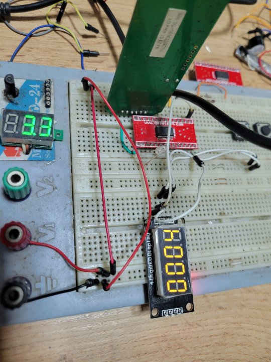

Same display, with two different hex FC8 :-)
