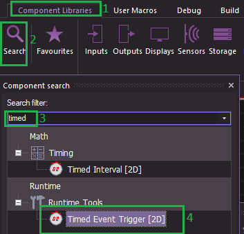

Matrix staff advice for using timed interrupts within PC Developer or embedded is to use the Timed event trigger component as that is easy to set up and works great for both embedded and PC developer.
To find it, you can select the Components Libraries ribbon, search magnifying glass and enter timed event
Timed Event Component.png (17.07 KiB) Viewed 12415 times

I tried this method, it's the third method with 1 second. But with this method the trigger event macro stop the process of my button macros when I push a new transmit / receive data button. I saw your example with graph and slider in the Flowcode Wiki. The Flowcode Wiki is great and perfect to start with the FC10.
I will check again with this component even if the minimum time with the trigger is 1 second, I need 500ms.
