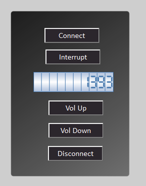

I find a solution in mixing two macro with interrupt on the long push macro. Work fine some minutes and the Interrupt stop without reason.
I added a simple counter on the "Simple Com Sender". Push on "Interrupt" button, you can see the interrupt itself stopped around 1300, 2600 ...
Have you this problem ?
Capture_2025-03-04 101027.png (18.97 KiB) Viewed 16859 times

One thing to try:
Move NumericIndicator1:SetValue(compt_test1) to the loop in main. I'm not sure about app developer - but in general you need to keep interrupt handlers as short as possible (if another interrupt occurs before the handler is finished then the code will lock up...)
I cranked up the interrupt rate a bit and it runs for longer (counts to 6000 then resets) - and repeats... If it locks - and it seems to eventually then the code seems to be still running.. I added a simple 'flashing' indicator - and that flashes even after the counter stops being updated (so maybe a bug in the numeric indicator? - or the timer interrupt stops?)

I also tried tying the flash to comp_test1 - in this case the LED stops flashing so it looks like it's a problem with the interrupt code.

Your var ".i" is no incremented by the interrupt but by the main. I placed "i" var in the macro started by the interrupt.
Work if you don't push button but when you push a button like "Vol Up" the interrupt is stopped.
I think the delay is also a problem in the main.

So, we can't use the Interrupt without your trigger ?
I use successfully the Interrupt in my embedded project, it work fine but because we can set the level priority of the Interrupt in the C code. Without Interrupt we can't design a a big project.
The problem about Interrupt in PC App that we have no priority level, the Interrupt are stopped by push on button or by the main.
I checked the updated project with "i" in counter macro, same problem. Without delay in the main, the Interrupt was not stopped by push on button but stopped in the time without reason.
