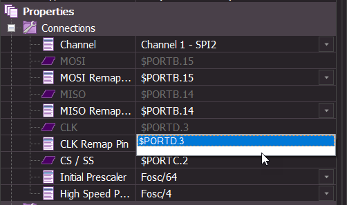

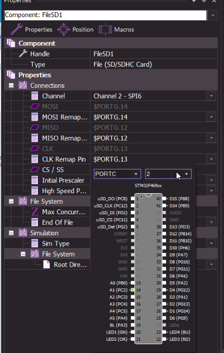

On my STM32F469I-DISCO board is a sd-card but I can not choose the pin for the sd-card
this is for:
SDI=D12
SDO=G14
CLK=A12
CS=B14 is ok :)

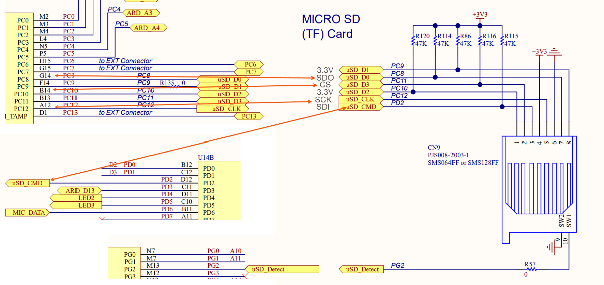

here the schematic

With this component I cannot select the pin I need to use the sd-card
For the CS is a nice option to choose the Pin
For the another pin it's not possible to choose the right pin.
It would be helpful if these pins were available for selection
Otherwise you cannot use the SD card.
SDI=D12
SDO=G14
CLK=A12
The same problem on this post with a STM32F405

edit: The circuit diagram shows port C pin 12, using SDIO interface, which Flowcode doesn't support.
Suggest trying software SPI mode?

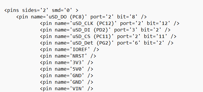

I can change the pin in the 32F469Discovery.fcdx and it's run it without errors
But it's not working to write a file....
I have probably mixed up port and pin, this I want to test and correct that.

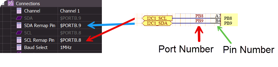

As a sample, the working I2C pins:
One problem, however, will be the CS pin. I have not yet found where to change it.
Only here in 32F469Discovery.fcdx
but I don't know what it is

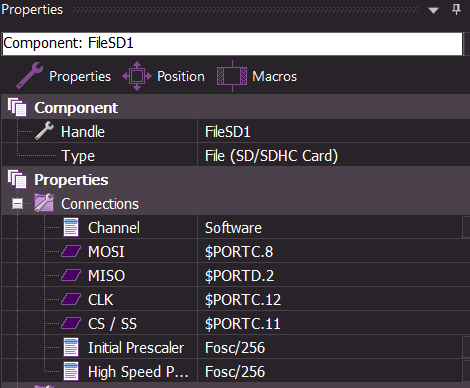

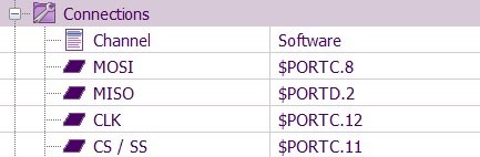

here the right port
SDI=D2
SDO=C8
CLK=C12
CS=C11
DAT1=C9 (set to 1)
DAT2=C10 (set to 1)

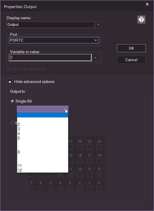

In softwaremode I can set the pin but not the 2 unused pin to set to high

Try a C code icon with
SET_PORT_PIN(C, 9, 1);
SET_PORT_PIN(C, 10, 1);

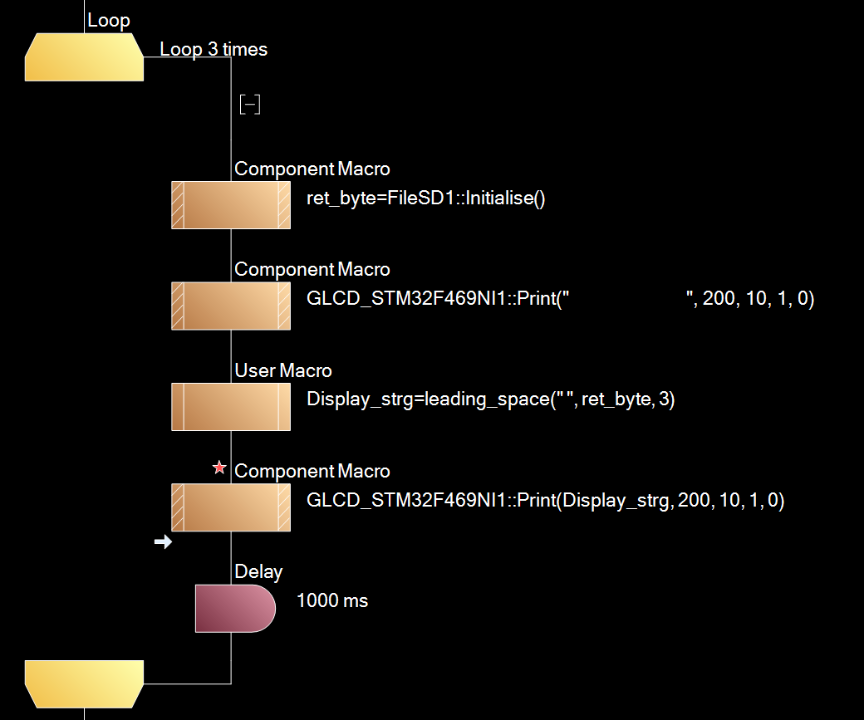

Posts: 1300
Has thanked: 246 times
Been thanked: 258 times
Re: STM32F469I-DISCO board SD-Card Pin not available
I tried with the c-code, but it is still not working, so i add the display and the ret_byte is alway 255
