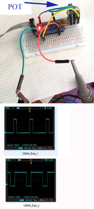

Hi Medelec
All good, works OK.
Thank you.
