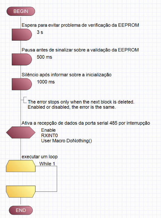

I was able to reduce the program to a single macro where the root cause is the interrupt block. The problem happen even if the interrupt block is disabled!
I recreate the 2D console with components from flowcode 10 to mitigate any problem on migration from PIC16F18345 to PIC16F18444, since there was some components for 3D only (on Flowcode 10) and my original code uses 2D only. Nothing change on error messages.

Thanks. I can see the problem and will ask for a fix to be released.

It should be fixed now - please download the new 16F18444.fcdx file via Library Updates.
