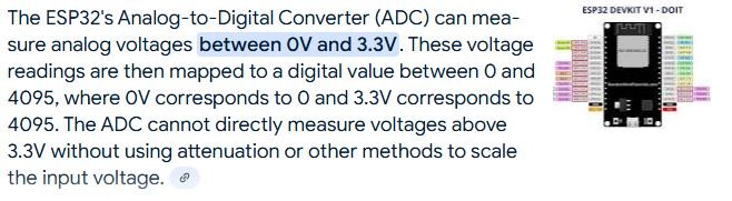

Post by KikeRico »
Hi, I read the issue. But take in account that for ESP32 all voltage mustbe between 0V and 3.3 V any value below or above these values must damage the IC, inlcuded the ADC converters :!:
Then I suggest to you check your before your circuit and do the proper arragement to input the signal as you wish.

Hi KikeRico!
Thank you for your advice. I am aware of the 3,3Volt and this is not the issue. I have not started a project with the ESP32 C3 yet. I have only try to compile a simple program ( loop and a delay) to Hex, and this is not possible, get error already in the begining of compiling. This is for all the C3 device.
