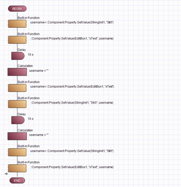

I need to push user value in a ROM array to save mqtt username and password in the C code. I tried with StringInit Component but when I push a new value in "Str0", this variable is not saved when I restart the Pc App.
This function is it possible without design a txt file ?
1 - I set the box with the Str0 string.
2 - I enter a new string and save in Str0.
3 - I read the string from Str0.
It's ok, I have my new string in step 3 but the new string is lost if I restart the Pc App. I start with the string of step 1, registered in the Str0 parameter.

If you want to use properties to store and load values, then you can use the Property Manager (Component Libraries > Storage > Utility).
It will crate a file for you, so all the hard work is removed.
Alternatively, if you attach your project, I can see if there is a better way of achieving desired results.
