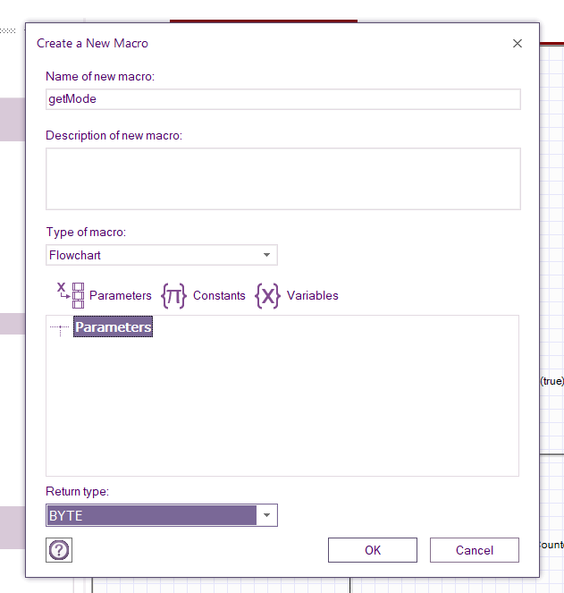

The return can be set in Flowcode using the 'return value' box at the end of the macro setup...
Screenshot 10-17-2021 16.03.01.png (29.65 KiB) Viewed 123311 times
Then to set the return value in the macro - in a calculation box -
.Return = value
Note that FC only has one return point (officially at least) - the end of the macro, but you can set the value anywhere in the macro - either then 'goto' the endof the macro - or depending on the code - just wait till the end is reached. (It's also possible to 'return' earlier using a 'C' block :-) )
