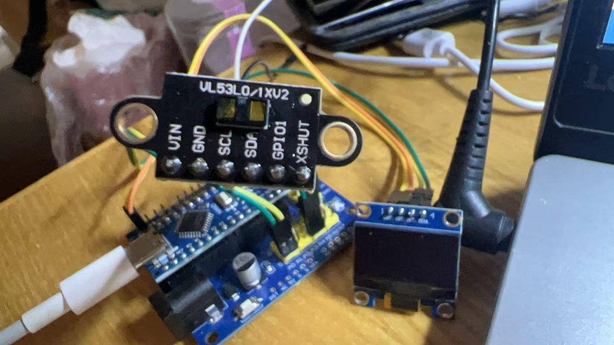

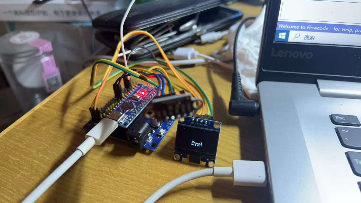

I'm currently working on a RangeTOF_VL53L0X project. It is displayed correctly in the simulation. However, it doesn't work when downloaded to the physical object. Help me!
- RangeTOF_VL53L0X.jpg (119.77 KiB) Viewed 4402 times

Can you be a bit more descriptive? What about it doesn't work? Many including myself have used it successfully and posted in the forum our experience. Have you searched those posts?

Without seeing a datasheet I can only guess that it is perhaps "latest generation" of the device and if so I would again guess that it would retain compatibility with original (perhaps with extra features).
There are many "clones" available from the usual cheap sites and some of them are of poor quality. In the tests I did on a couple I did not get anything like the claimed accuracy, but it was still perfectly good for my application.

I got curious so I tried to test. I have the same one as 17712885438 have. In my experiment I have used an I2C LCD display connected to C4 and C5 same for the sensor. I have another model VLX also and both work
You could try to change the display in my examble and see if it work.
Good luck
Jorgen
Good luck
Jorgen
