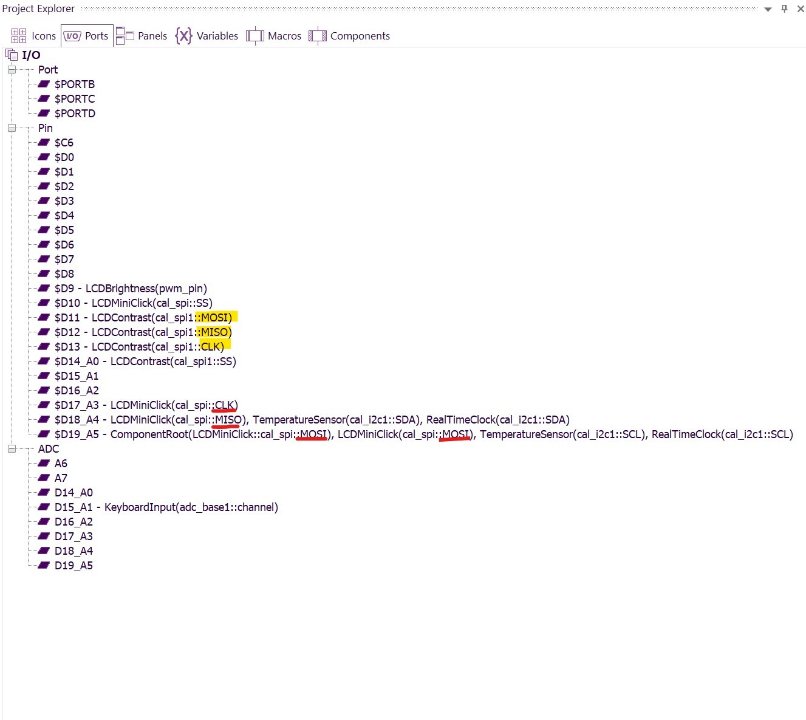

I am trying to build a project with the Mikroe MiniClick LCD, and it appears that there are a few problems with this component:
1) The number of characters is not being displayed, despite indicating clearly that there are two rows and 16 columns. Actually, this section should be non-adjustable, as the component has a fixed configuration.
2) The MOSI / MISO / CLK pins are fixed and cannot be changed. Therefore, they are being assigned automatically to PC5 / PC4 / PC3, and they should be connected to Port B instead, as follows:
MOSI - PB3
MISO - PB4
CLK - PB5
See a print screen from my project, with the pins assignment.

I believe that the MiniClick LCD pins are being incorrectly assigned, and I am unable to change them because they are being grayed out.
Has anyone from Matrix TSL tested the actual hardware before publishing this component?

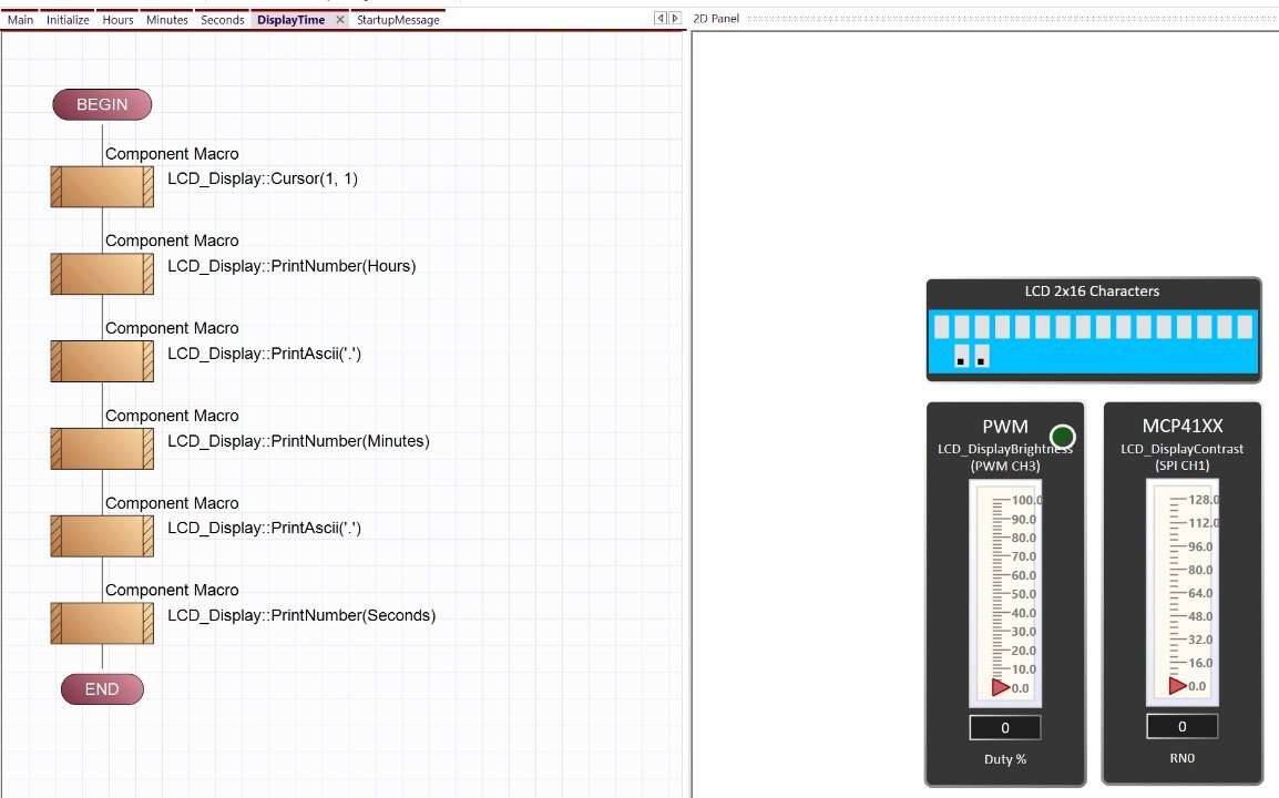

3) When I try to print some characters on the LCD, the digits are not entirely shown in the simulation.
Screenshot 2025-11-08 142804.jpg (96.33 KiB) Viewed 3284 times
For your reference, I have enclosed the project to which I am referring.
I want to display the hours, minutes, and seconds from the RTC on the LCD. How can I do this?
Digital Clock v0.2.fcfx
(22.85 KiB) Downloaded 279 times

Briefly, I see you have not initislised any components so it is unlikely you will have much succes.
I'm traveling just now but will reply in more depth later.

As Chipfryer27 states you need to start by initialising the components.
The pins on the miniclick LCD are fixed but you can change the pins on the RTC to avoid conflict.
Convert the Hours, Minutes and Second bytes to strings and use Print String to display the data on the LCD.
In the RTC Component Macro under GetSeconds move the 'seconds byte' to the Return Value (BYTE) window. Do the same for Minutes and Hours component macros.
Study the flowcode program attached carefully. It should get you started. Good Luck.

The pins for the display are also incorrect - and can't be edited in either hardware pr software mode - which looks like an issue with the
LCD component. The Nano needs these to be set to port B - as mentioned above...

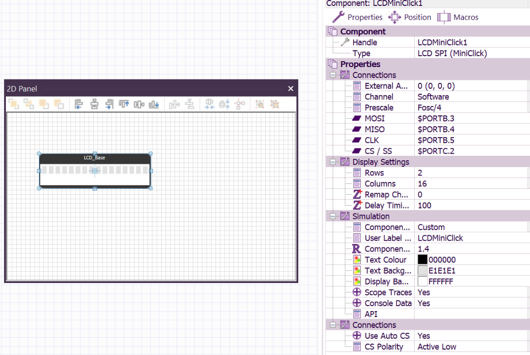

Many thanks for the bug report.
Can you try with the attached component.
%ProgramData%\MatrixTSL\FlowcodeV11\Components
Place the attached component.
LCDMiniClick.fcpx
(9.66 KiB) Downloaded 263 times

In my existing project, with the new library component, everything was working as expected, and I was able to change the pins, just as I would for a new project.
