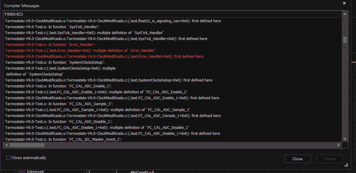

I'm trying to compile my flowchart for the STM32F030K6T6 using the new version of flowcode 11 that I purchased, but I'm getting this error. The flowchart compiles normally in version 10, but not in version 11.
What could this be?

Can you provide your project .fcfx, msg.txt and .fcxlog.txt files
If you want to keep the project private, you can PM me with the requested files.

I managed to solve the problem.
I copied the original flowchart to a new folder and deleted the files generated by the problematic compilation in the old folder. After that, I was able to compile normally again.
