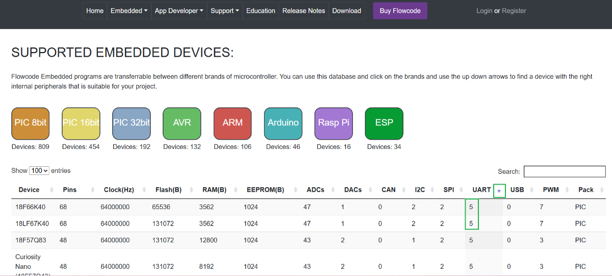

If you select Embedded > Target Selector, that will display all the target devices Flowcode supports.
You can then Select PIC 8bit, then change the Show 25 devices to 100.
Finally click the Arrow to the right of UART, so it shows pointing down.
You will then see the total supported UARTS:

Many thanks for pointing out the links, yes indeed the target selection helped me to identify the chip I wanted, and found one with 4 UART, and the best part is I can use that for free, thank you to FC.
