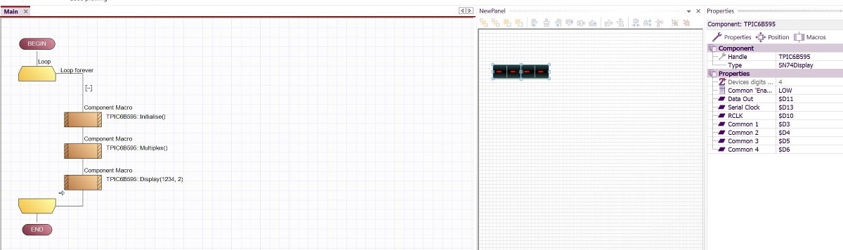

Would it be possible for you to make some cosmetic changes to the component and, for simulation purposes, add pins for L1L2 and L3? I am using all of them in my project, including DP, which is common to all four CA1-CA4. I know I can use LEDs, but I want a nicer display that includes everything.
Right now, the display component looks as follows:
What I would suggest is to overlay the display from the datasheet of the TDC.1050 and make a whole display that depicts the exact angles, L1L2, L3 and DP placements.
Eventually, if it's someone from Matrix TSL who's interested in this component, I can send it from Sweden to the UK for additional testing, and with my request to add it to Flowcode as a component, specifically for pairing with TPIC6B595.
Andreas

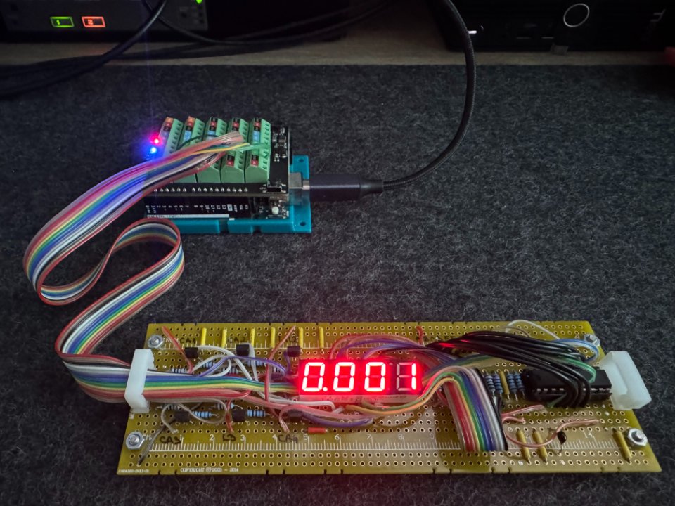

TPIC6B595 prototype
I have managed to wire the display board, and it all works fine: Unfortunately, I cannot figure out how to display digits on the enclosed TPIC6B595 component, which I placed on C:\ProgramData\MatrixTSL\FlowcodeV11\Components: Let's start with the string 1234... How do I do it?
Andreas
Andreas

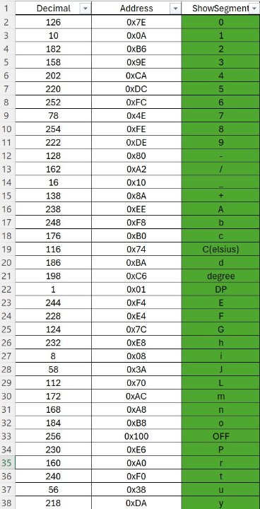

I am now working on a digital clock with an Arduino Uno, a DS3231 RTC, a TPIC6B595 (for high-current support), and a display called TDCR1050M (common anode), just to avoid a lot of wires and... because I like the display, the idea of using shift registers, and I like a scalable design. Unfortunately, as you can see from the schematic, I ended up with at least 24x resistors and 6x MOSFETs... and somehow an unusual HW design. I think it's easier to source an 8x digit 7-segment display already connected to a MAX7219 than to do a breadboard as I did - it took me one day to assemble it. I also have the option to use the Arduino Uno's PWM to control, let's say, the L1L2 blinking column for seconds.
To answer your questions:
This is useful for someone who respects the wiring and knows what kind of letters will be there. But, for example, I have the Mikroe 7seg Click, where some wires are reversed and do not follow a standard. Therefore, I've had to test each address manually and see what I will get on the display, and here is the result:
Andreas
Try not to make a fixed lookup table, because I will define each character in a hex value from 1 to 256, and they will become Constants in my code.It would take a little work to change the component - it needs to use the larger lookup table of character data and would need a 'DisplayStr' macro or similar?
I only need a field to enter the values between 1 and 256, as in the upper value, and get something. I need to be able to tell the value and the column (ideally, it would be if you could make a display configurable between 1-8 segments).Multiplex might/would need to be altered to access the extra characters depending on how you want to create the displayed values?
Maybe this is similar to what I did earlier in my Excel table? (I have experience with electronics, but not with coding, so I don't know if we are talking about the same)Another option would be just to modify multiplex and pass an array of 'segment values' (each a byte) and pass this to it instead?
Andreas

Sounds interesting. The DS3231 is well known and easy to use - accurate too.
I don't quite follow your table - if, for example, I want to display '1' - I need to find the segment pattern for this. There are several ways to do this - but a a lookup table (an array or a LUT) is quick and linear time.
so .segs = lookup[1] ? Or if using ASCII .segs = lookup['1' - '0'] (lookup contains data for digits 0..9)
Multiplex needs to know what segments to display (so each digit is made up of 1 byte (8 bits) - where each bit corresponds to one segment) - this might be better served with 'display_data[4]' holding the segment data for each of the characters in the display and Multiplex using this?- and the DisplayTime(str) - macro can lookup / calculate the required segments.
As an alternative - if the lookup is in RAM then a SetCharacterSet(data) macro could be used?
Possibly - I think we are really trying to get the same result.Maybe this is similar to what I did earlier in my Excel table? (I have experience with electronics, but not with coding, so I don't know if we are talking about the same)
