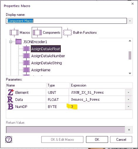

I have a program that is working well so far, I changed the NumDP in AssignDataAsFloat to get 3 decimal places and this worked as expected for the first value.
I then tried to do it for the other 3 values (or just one of them) and it basically seems to lock up the web app where nothing changes. I can see the data being sent (or at least the string prior to sending) but the web app just stops working.
