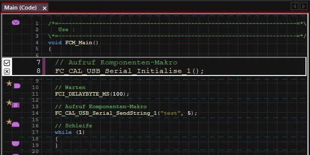

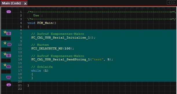

Here’s the thing: for example, I create a new project as a flowchart. Then I can switch the view to the code view. Using Ctrl+A and Ctrl+C, I can copy the content and paste it into Word, for instance. It was working for me until yesterday. Now, when I press Ctrl+A, everything is highlighted in green, and that’s it. I can now only copy individual bits of text like this one: FCV_GV_ADC_RAW_FLOAT = flt_add(flt_add((flt_mul(flt_fromi(FCV_GV_BYTE_HIGH), 65536.0)), (flt_mul(flt_fromi(FCV_GV_BYTE_MID), 256.0))), flt_fromi(FCV_GV_BYTE_LOW));

In the latest update of Flowcode (v11.0.1), copying icons no longer copies as a text-based format. You can still copy icons and paste them into other flowcharts in Flowcode, but you cannot copy the icon contents directly in a text format for pasting into Word (etc).
However, you can copy the C code text from the Build...View Code menu. This will copy and paste as text.
