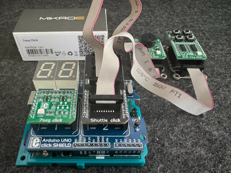

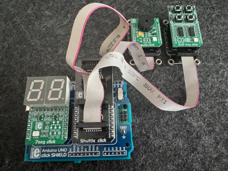

I have started to work on a kitchen timer that uses the following parts:
Arduino Uno R3
Mikroe Arduino Uno Click Shield
Mikroe 7seg Click
Mikroe Shuttle Click + 2x mikroBUS Shuttle
Mikroe Buzz Click
Mikroe 2x2 Key Click
It takes less than 10 minutes to assemble all these pieces from Mikroe, and up to 15 minutes to verify the connections.
The project will be based on my earlier version of a kitchen timer with LEDs, which I am now adding a display to:
viewtopic.php?t=3513
I will share the code with the community once I have something ready and request your help in completing my project.
