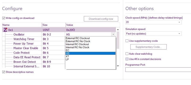

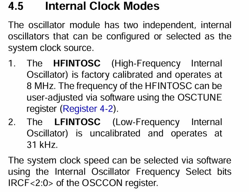

The PIC16F886 has a 8MHz internal oscillator (pic 01)
I can't figure out how this can be selected (pic 02)

Re: PIC16F886 internal clock settings
The default frequency of the internal osc is 4MHz.
What you will need to do to change it from 4MHz to 8MHz.
To do that you will need to add Int Osc Helper which can be found within Component Libraries > Runtime > Matrix Tools.
After adding to the 2D panel, Right click on it and select Help.
That will give you the instructions to set up your project to run the internal osc at 8MHz.
Hello Martin,
Thanks for your reply.
To be sure, I have to select "Internal RC clockout" in the Project options?
There is no INTOSC in the project options list to choose.
Or is this overruled with the C code?
Rinie
Rinie
Within Project Options, you either select Internal RC no clock, or Internal RC Clockout.
The latter uses the OSC2/CLKOUT pin and the output is FOSC/4.
The actual frequency is not changed within Project Options.
The Clock speed within Project Options does not change the actual internal osc speed.
Its purpose is to be used with components and delays for timing purposes.
What changes the internal OSC frequency is the value of the OSCCON register via a C code block.
By changing the values within the C code shown within the Internal Oscillator Helper component, the frequency of the osc will be changed. For example, using OSCCON = 0x70; the internal osc will change from the default 4 MHz to 8 MHz.
As per instructions on the wiki, within the properties of the Internal Oscillator Helper component, select the required frequency, and copy the code to be pasted within the C code block at the very top of Main.
