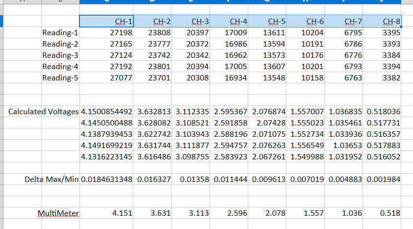

I took five readings and documented.
ADC Readings.png (45.13 KiB) Viewed 4864 times
As you can see from the above when compared to the readings taken with my multimeter it seems to be reasonably accurate given my basic test set up.

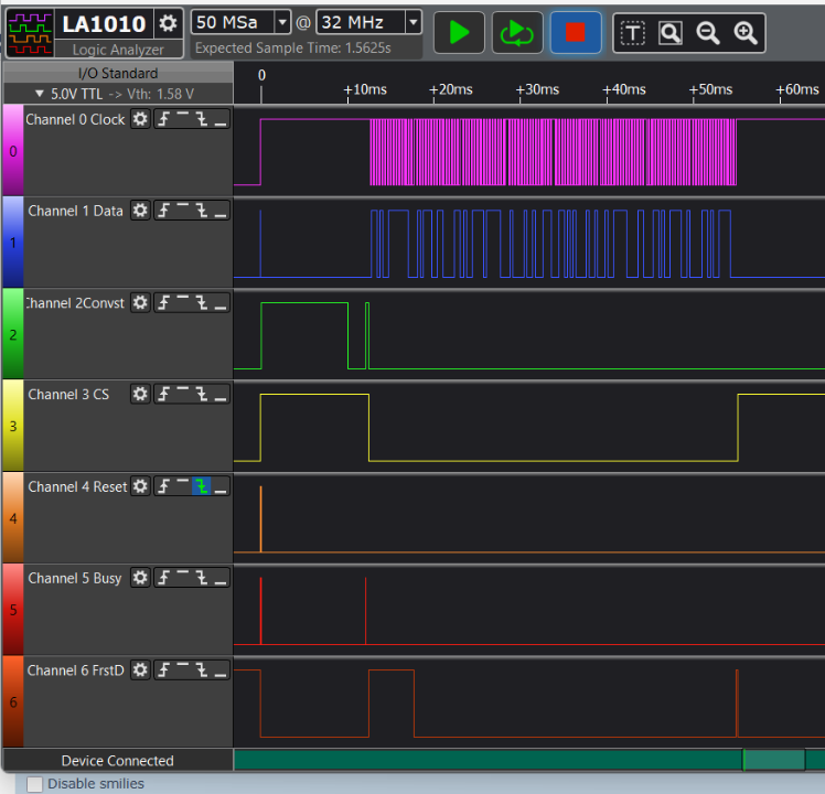

Below are traces from my analyser
The important sequence is as roughly follows:-
Reset goes low, subsequently Convst is taken low and then high which signals to start sampling. Busy goes High at this point too. We do nothing until Busy returns low indicating sampling complete and this then takes FrstD high indicating first data channel is ready to be read. CS goes low, Convst is taken low to hold, and we pulse in data. After the first channel has been clocked in FrstD returns to low. After all channels have been read CS return to high.

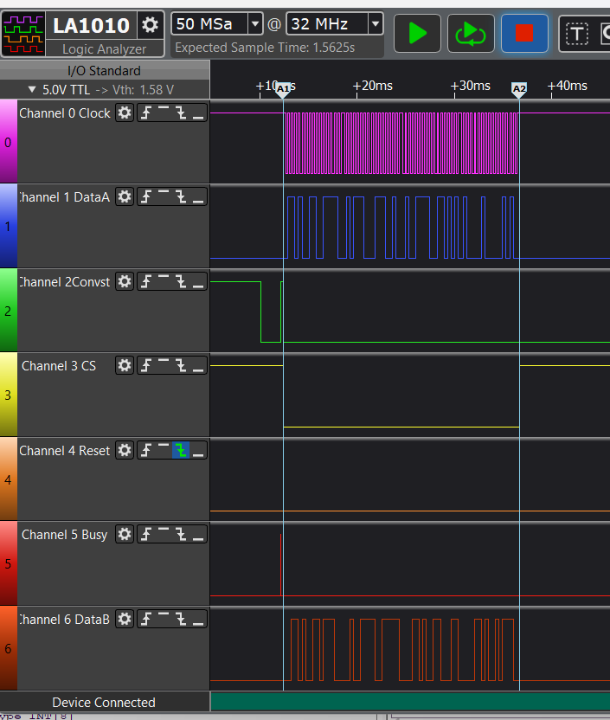

Just a quick update.
Not had enough time to explore much further but I did connect in DoutB. This then allowed me to read channels 1 and 5, 2 and 6, 3 and 7 finishing with 4 and 8 at the same time thereby reducing time taken to read by approximately 50% (roughly 24mS).

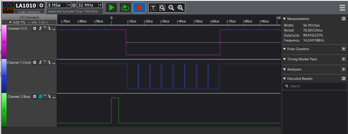

Very pleased with the results. I started a capture when "Busy" went high which starts the sampling. When it returns to low that signifies the sampling is complete. I then pull Chip Select low and pulse out the readings, one pulse per ADC channel. The traces below show that it took 56.78uS to read all eight channels.
I do realise I need a more powerful microcontroller to realise the full potential of the module, but for my initial tests the 8-bit PICs are doing fine :)
