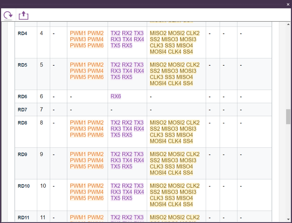

I have a question.
Is it impossible to use the RD7 as the UART RX on the PIC24FJ512GA606?
Thank you.
Posts: 2391
Has thanked: 759 times
Been thanked: 825 times
Flowcode v11 Re: Question UART Pin Mapping
A new Flowcode v11 only feature.
Within Flowcode, select Build > Online Stuff > Target chip peripheral pins
Within the new window that opens select Upload Project icon then Reload icon
You can then scroll down all the pins to see what they support.
Below is what you should expect to see:
peripheral pins.png (244.04 KiB) Viewed 32 times
