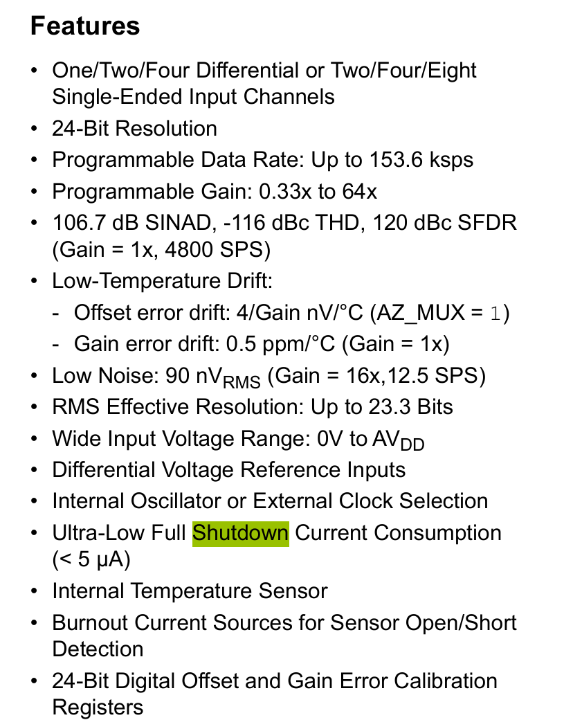

The MCP356x1 is a nice 24Bit Ad converter.
There is a one-channel, two-channel, and four-channel version
with SPI and many possibilities and features.

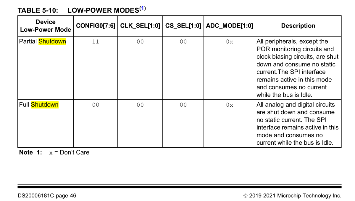

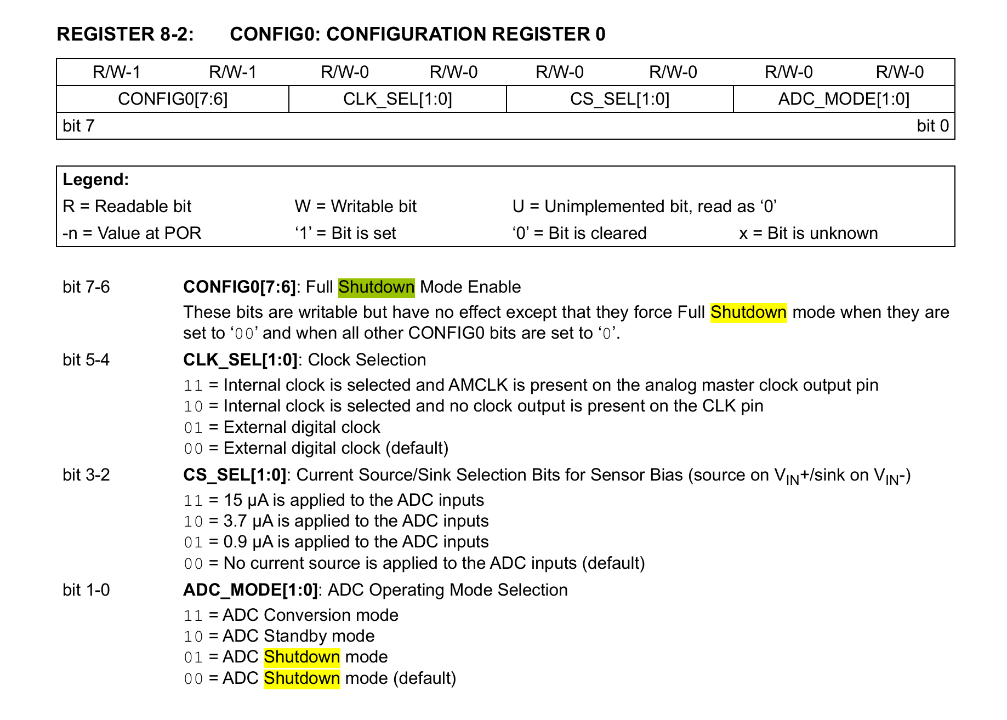

But especially with battery-powered devices, which are usually most time turned off, the Full Shutdown mode
would help reduce power consumption during deep sleep
Would it be possible to create two command?
Set Full Shutdown Mode
Exit Full Shutdown Mode

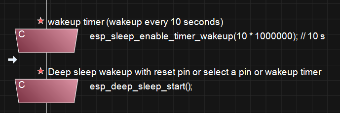

an ESP32 is simple to set in deep sleep mode:
