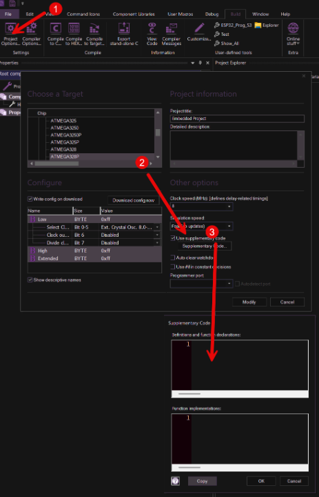

I think you should split up the C code and paste it here.
Use this:

You can't copy and paste flowcode generated C code and expect it to compile.
For a start there will be duplicated Main and functions which the compiler will reject.
Why would you want to re-add generate code anyway?
