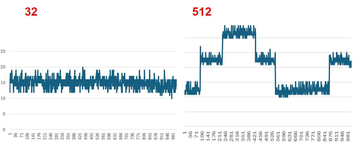

I recorded two signals using different oversampling settings. At 32, the noise is higher, but there are no steps in the signal.
with 512 unfortunately, it's reversed but not better.
It would be convenient for me if I could read and set all the registers.
Some I2C components have a read/write command in Flowcode;
perhaps this could also be added for some other SPI components?
The same signal recorded twice with different OSR values and saved in two files
Oversampling 32...512

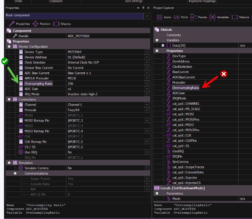

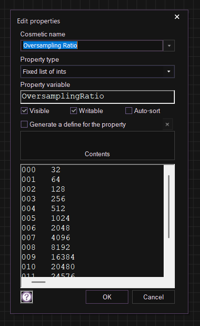

I have a question about the properties in the components.
Do I have to view and edit them with a text editor, or is there another way?
					<property name='AMCLK Prescaler' target='Prescaler' typeid='16' hidden='0' locked='0' info='' filter='000MCLK
001MCLK / 2
002MCLK / 4
003MCLK / 8' />
					<property name='Oversampling Ratio' target='OversamplingRatio' typeid='16' hidden='0' locked='0' info='' filter='00032
00164
002128
003256
004512
0051024
0062048
0074096
0088192
00916384
01020480
01124576
01240960
01349152
01481920
01598304' />

Sorry, that was my fault. I didn't notice it.

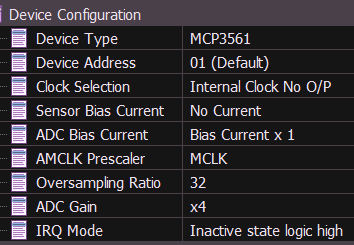

doubleclick on the left side propertis open the menue.
Not working in variable part :)
Wrong place to click...
Menue:
