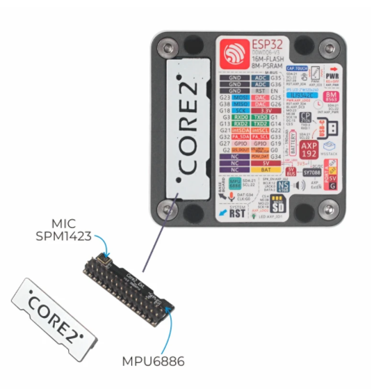

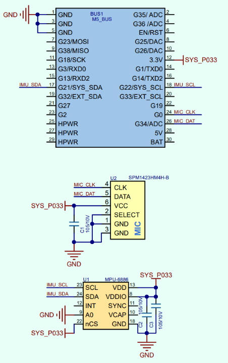

I now know what I did last time.
The last time I used some pin from the extension connector. I removed the cover from the connector.
On this cover is unfortunately a mpu6886.
Today, the test was with the cover and I think the mpu6886 give this problem.
So I removed this connecter and reading from the AXP192 (I2C) is ok again.
I will have a look, why the mpu6886 make trouble.
I attached a picture from the cover and connector.
regards and sorry
