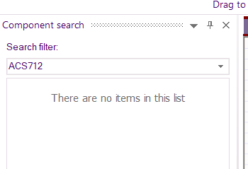

Hi again.
I dont think so ;) Can´t find it, either in FC8
I think you are thinking of this thread that was apparently never made a component for ACS7xx, but would be nice ;)
https://www.flowcode.co.uk/mmforums/vie ... acs#p98662
Jorgen.

jgu1 wrote: ↑
Wed Sep 01, 2021 8:52 pm
I dont think so Can´t find it, either in FC8
Ah, sorry you are right, it's my mistake
Leave it with me and I will get something sorted out for you.
You will have an ACS712, by end of tomorrow.
