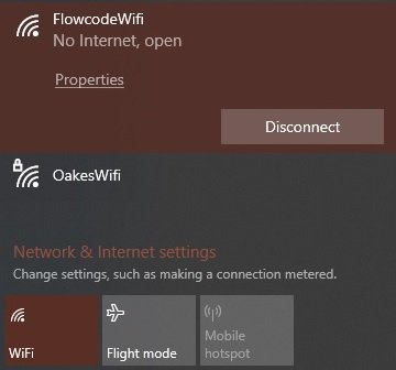

If the connection was not successful then the ESP creates it's own open network called FlowcodeWifi. This SSID name can be reconfigured as required and even made so a specific password has to be entered to allow access.

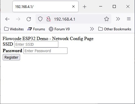

If you connect to this network and then visit the URL 192.168.4.1 then you will be presented with a configuration page.

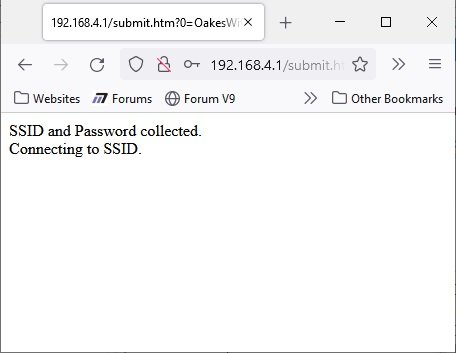

Upon filling out the details in the page and clicking submit the confirmation page below will be shown, the entered details will be stored and the ESP32 will attempt to connect to the network. If successful then the FlowcodeWifi network will dissapear and the ESP will continue with the program as before.

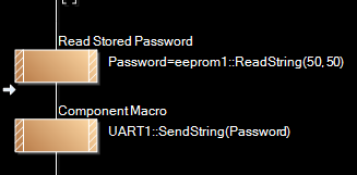

For a test I loadet a complet new program in the ESP32 and read the EEprom and send it to the USB-C.
I received realy my password.....

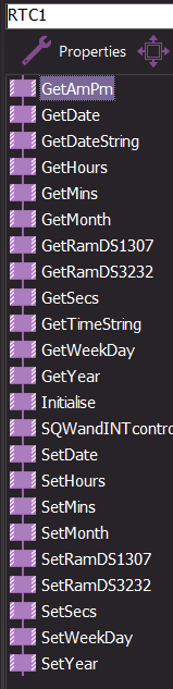

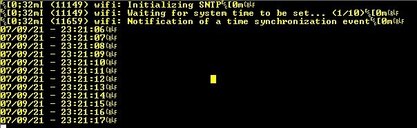

What I'm missing are some set command to set the TimeDate with Touchscreen, Bluetooth or USB
The RTC1 component (Real Time Clock Internal, DS1307, DS3231, DS3232) is supporting a lot of set command
but for me is a setcommand for all in one go also possible even without a separator like.
"yyyyMMddHHmmss"
The RTC1 component with a lot of set commands:

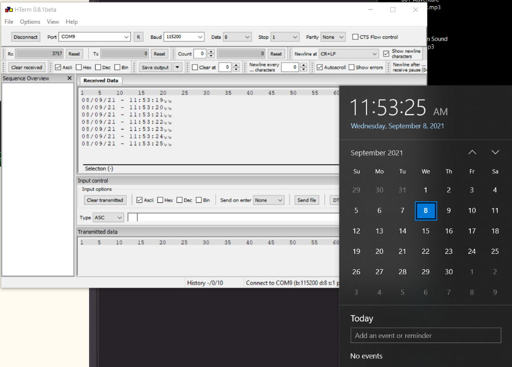

Working perfect received string from the ESP32 (set by wifi) and my computertime:
