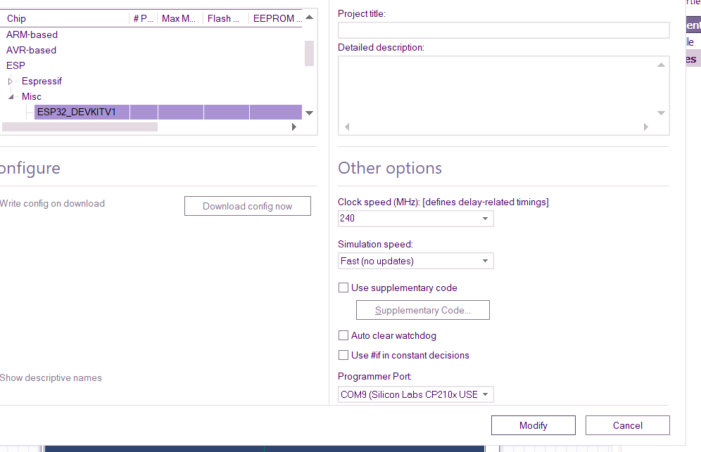

Hi MM!
Carry on with me. But now that I have bought FC9, I would like it to work :lol: Again maybe I do something wrong.?
Now I have installed FC9 on my other PC (similar) again I am not able to program the ESP32. In Program option I see the Port, but port 9?
Click Modify to accept, but it will not program the chip.
Please what to do.
Br Jorgen

Hi Jorgen,
Looking the log file it would indicate that it is not the programmer port at fault this time.
The ESP toolchain is failing for some reason.
It might be worth reading through the Wiki and PDF instructions, and also this post ...
viewtopic.php?p=162#p162
Just one thing worth a try ...
It seems that some have had better success by installing the Espressif tools at C:\.espressif,
rather than where you currently have them at C:\Users\jgu\.espressif
Hope that helps
Leigh

Ah, just spotted this ...
C:/Flowcode9/Forsøg/Slet/New_PC_not_compile
Could you try creating the Flowcode project in a path that only has base ascii characters?

Hi Leigh!
Well ok. I create c:\Testing\ filen name ascii´. Now I can compile to the chip :D
But how could it be that I not can compile in the other pat? No probl. on the other PC either no problem here on this PC in FC8?
The other bug with the Ili9341 as not working with ESP 32 (created on the other PC) do you have any idea why this not work?
