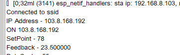

I sorted out reading the IP i was trying to create an access point instead of connecting to the SSID of my rougher now the only thing is that it reads the IP backward is this a fault of the component?

Hi Brian,
Thank you for the spot.
I have hopefully fixed the issue.
I will ask Ben to add the component to the update system.

Hi Brian.
The component is now on the update system.
