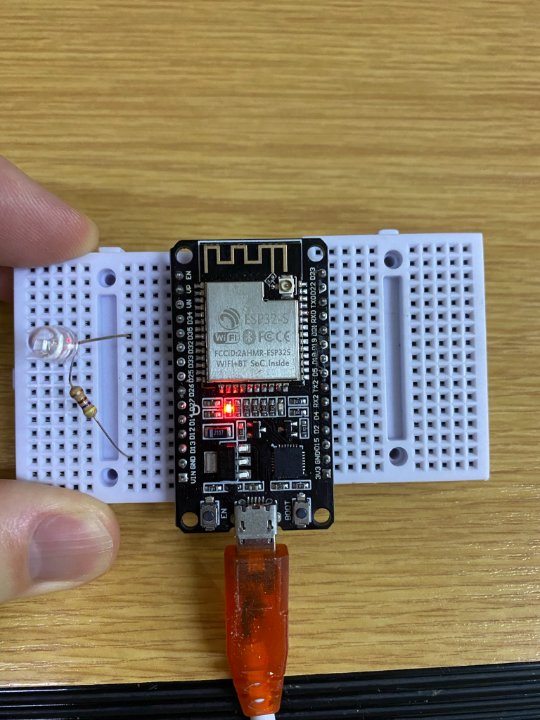

hi, I have uninstalled everything and reinstalled it again now compiling and downloading ok
but the esp is not booting it is panic and reboot by itself I am using ESP32s any idea what can be causing this.
This is what I get from the serial port from the ESP maybe can help to understand the problem.

Good morning,
I am just trying to blink an LED for now on pin 11 ( GPIO 35 ) that's all .

Re: ESP32 Can't compile
I think we've caused some confusion by using the word "pin"
Pin 11 = A.11 = GPIO11
Another thing to consider.. GPIO35 is input only, so we can't swap to that
To determine an available output to drive the LED I will need to dig out info on this AI ESP32S board,
unless you get there first
edit: try a bit further down on GPIO25 (Pin 25, A.25)
There is a very important note here ...
https://docs.espressif.com/projects/esp ... /gpio.html
Which includes ...
Which includes ...
- SPI0/1: GPIO6-11 and GPIO16-17 are usually connected to the SPI flash and PSRAM integrated on the module and therefore should not be used for other purposes.
- GPI: GPIO34-39 can only be set as input mode and do not have software-enabled pullup or pulldown functions.
Hi LeighM ,
Yes, that was the problem, output on GPIO25 the ESP does not panic and working fine now.
I didn't know that some pins will cause the ESP to panic and reboot if set to output.
would be a good idea to disable those pins in the output icon.
And yes it would be less confusing if the pins were labeled GPIO instead of pin .
Thanks for your help LeighM.
