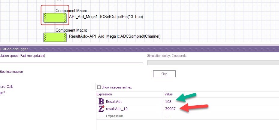

I am not sure what I am doing wrong however using the ARduino mega2560 API-Scada the ADC Sample8 is working fine but the Sample10 is give absolute wrong and impossible values.Samples taking on the same channel(A0) one is correct and the other is not any help appreciated

Hi Team,

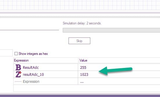

Thanks that is working perfectly now

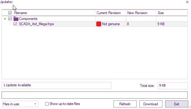

Fc wants me to update the same file now when I open the FC project if I do that then it seems it updates to the old file and things stop to work again
I then placed the file again and did not update FC so it is working now but in future if there is other updates it mights swtopped again to work
just to inform I am ok for now I can do what I need to do

The component is only temporary until Ben pushes the update onto the system.
It's showing Not genuine since the update is manually added and not via the download button.
When the new revision is 9 instead of 8 then you can download it, and override the Not genuine version.
I will let you know when it's available.
For now, you can leave it as showing Not genuine so your App Developer is working as expected.
Don't forget you can untick the component if there are other updates as well, but if there are new updates then SCADA_Ard_Mega.fcpx will be one of them.
