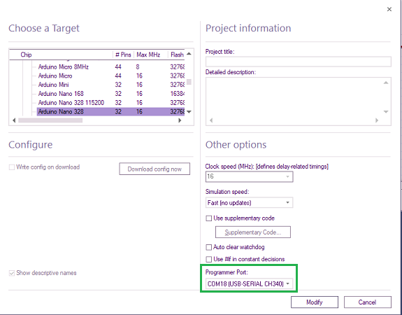

Hi.
As Martin said, you don't need a programmer.
The USB lead is connected from Nano to your PC.
Make sure the Nano and the port are both selected within Project options:
Select compile to target.
I have just programmed my Nano:

If the Port is not listed, then check you have the correct drivers installed for CH340.
You may need to reload Flowchart after installing drivers.
