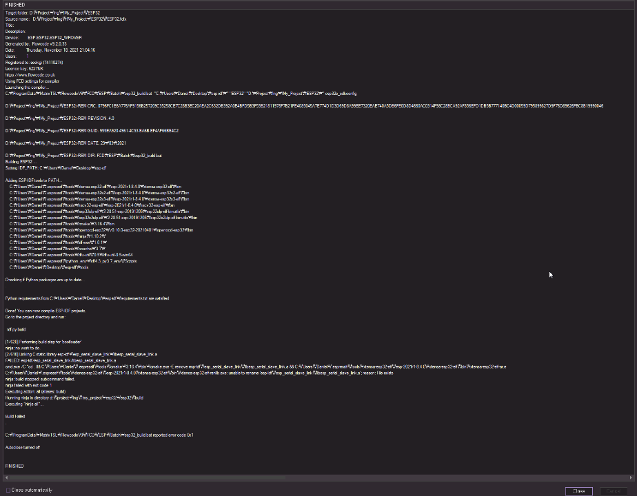

ESP32 compile does not work. I've looked through the forums, but I don't understand.
Please help.
ESP32 WROVER
Win11
thank you.

Can you please attach the msg.txt file?

Yes Thank you
ESP32.msg.txt

looks like you are using latest esp-idf
unfortunately there seems to be a bug in it relating to invalid x509 certificate
I suggest that you go back to version 4.1.2
